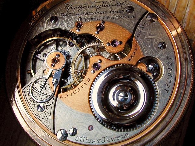

Doug RomeroSam, Fred and others,
Here is a pix of the 16 size grade 179 Monty Ward Extra RR Timer Special Thin Model I have. I thought I posted it sometime ago. The pix is so-so. Need to take another one.
Question.....Note that mine has gold flashing on the balance staff. I wonder if that is correct? For comparison, I will post another private label 179 that Fred posted last year (hope that is OK Fred). I searched on 'grade 179'. It is a really nice thread (some great pix).
Anyhow, note the slight differences in the flashing on mine and the one Fred showed, such as mine shows flashing on the balance staff and Fred's does not. Makes me wonder if mine is proper. Anyhow, I just found this interesting.
Doug

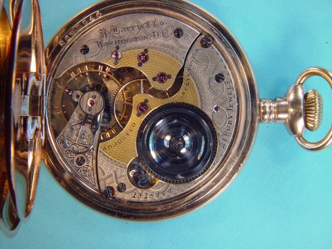

Doug Romero Link to other grade 179If I messed up the URL above, here is the pix that Fred showed of another grade 179 very similar to mine tp compare.
Doug

___________Hi Doug -
I love those "Special Thin Model" markings on the Wards Getty Models, and with the "Extra Railroad Timer" as well on your 179 it is definitely a great combo!
Regarding the 2-tone pattern though another area of difference you might notice is that the Harris is not gold colored in the area below the click. Not saying that yours is incorrect, just that it is a little different in certain ways than the rest I am used to.
Another point you might look at is the boundary between the nickel and gold regions. Here is a close-up on the train bridge of that of the Harris marked 179 ...
... and you can see rather than ending as a simple circle, there is instead a boundary line of nickel finish and then after this a small surrounding row of gold colored spikes (almost like the teeth on a winding wheel).
I'm not sure if all 179's I've seen originally had these "spikes", so there may well be some minor variations in the pattern. But overall I would expect all of this grade to have a clear and precise boundary between gold and nickel regions, and if I were suspicious of a watch I would definitely look for any unevenness or inconsistency in this boundary.

Doug RomeroFred, Thanks again for the input. Looking closer, I am suspicious that someone 'touched up' the one I have.
So it will go up for sale or to another member so he can have consecutive serial numbers.
Doug

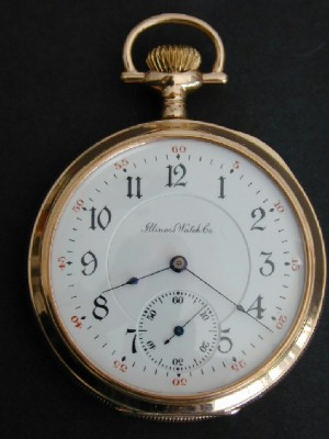

Doug RomeroUnfortunately, it does not have the Monty Ward private label dial. One it does have is pictured. My guess all these should have a private label dial.
Doug
