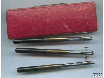

I bought a couple of tools and i will attempt to posst pictures and if more are needed i can post more later.
these are old and i do not see any names on them

correct image as follows

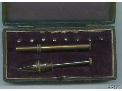

2nd image of tool

First Image: I believe these are used to work jewel setting holes. They also work well in a pinch for holding small items such as balance screws.
Second Image: No clue!

Both tools are for repairing burnished-in jewels. The first photo shows tools that (I believe) are only for opening the lip in the plate so that a new jewel can be placed. The second photo is a set that includes one adjustable tool to open the setting and an assortment of tips used to close the setting again.
