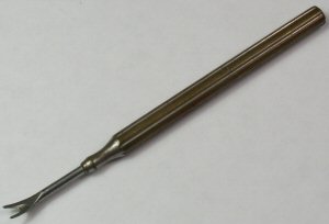

Wayne C. AndersonJim
Are you asking about specialized tools that would be need for hair spring work in addition to regular watch repair tools? Of course one of the first would be a Hairspring Collet Remover tool. (this one was made by K&D).
February 04, 2004, 17:03
Jim Cope...yes Wayne, exactly...particularly those tools to be used in straightening and otherwise reconditioning h'springs gone awry...I have a removing tool similar to the one you've shown which I keep razor sharp and tip-protected...Jim C
