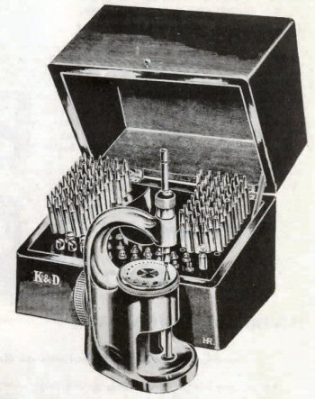

Wayne C. AndersonJessica,
Another common staking tool set was made be K&D. This is the model 600 "Inverto", and these can be found on E-Bay frequently.

Jessica LaneOn Wayne's set, for example, there's a part that's cross-hatched bowl-shape with a hole at the top at the very top of the front arm. That's what I mean by "top." What does that do. It's aligned with the corresponding holes in each part of the set, so it must do something. I don't really understand how this works. Is there anything that moved vertically? If so what? I know the plate with the circle of holes move around, but how do you do anything if nothing moves up and down? Sorry to be so uninformed, but I'm afraid I don't quite understand.
Jessica
June 04, 2004, 17:20
That is where the stake would be placed. This picture may show the use of a staking tool better:
A bit more information, the little short ones are called stumps, the long ones are stakes.
