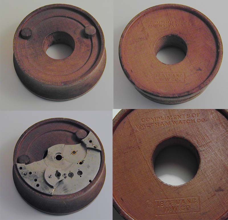

Jerry TreimanWaltham '92-model movement holder
