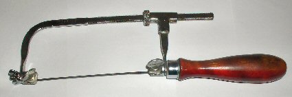

Should the blade in this type of saw to installed so it cuts on the push or on the pull?
September 19, 2004, 19:11
Scott Cerullo
The teeth should point towards the handle. This would make it cut on the pull.
