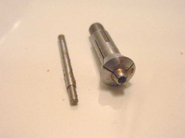

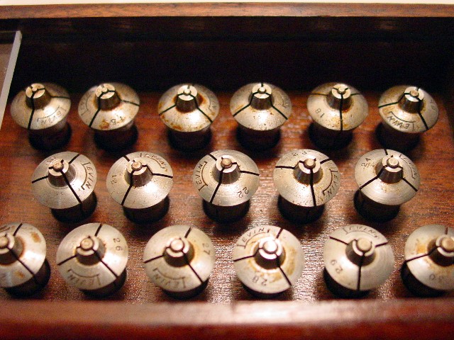

What kind of collets are these ?
These are different than the other 8mm collets Dad used - are they special purpose of some sort? They are a boxed set of 17 (Levin) , marked 14 thru 30.
Metric I assume?

pic 2

Chris Abell
Hi Kevin,
Looks like jewel collets, just sold a set myself here recently different make. Looks like the center rod slides in, my set screwed to get depth
