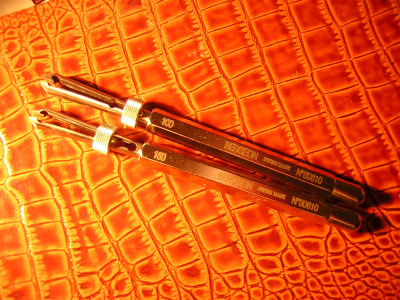

November 26, 2009, 00:45
Scott CerulloJust a follow up on Chris's post on the pinvice for barrel arbors. I just started using the Bergeon barrel arbor holders instead of the pinvices. These things are heavy duty. I wasn't sold on them, but the AWCI required them. Now I really like them.
