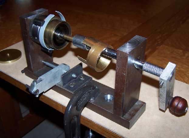

Here is a picture of my latest project.
This is one view of a mainspring winder I just completed. The brass disk is used after the spring is out of the barrel. More pictures follow.
Joe

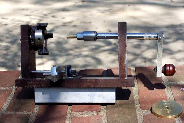

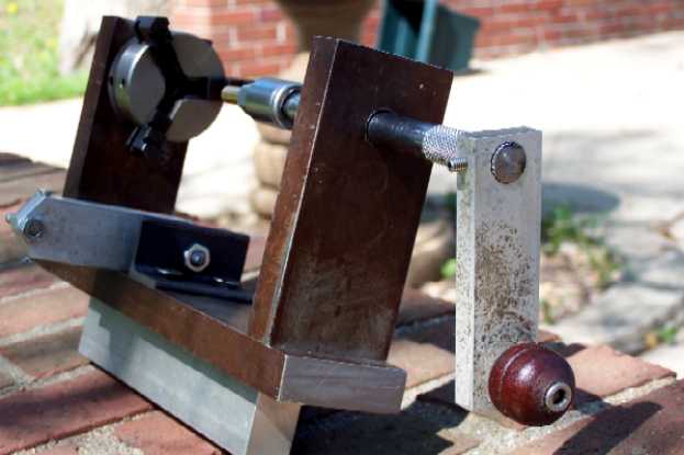

Joseph T. CollinsA different shot showing the lathe chuck that does the hard work.

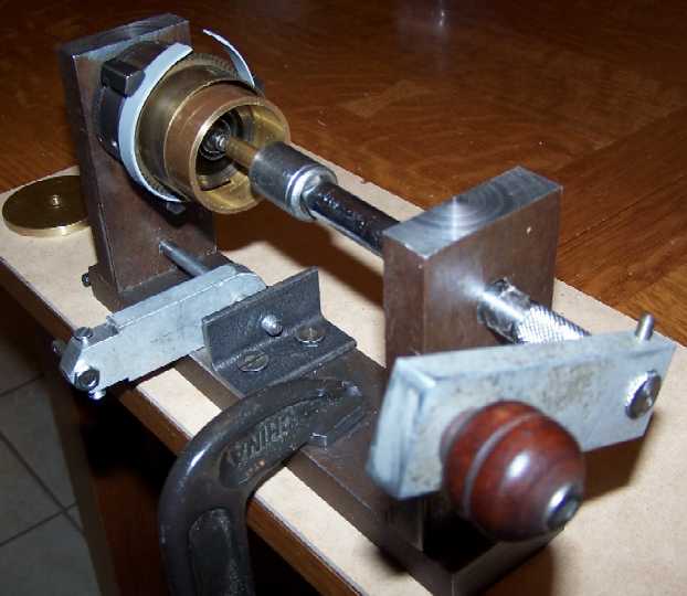

Joseph T. CollinsLast picture showing the brass disk in place to help control the spring while removing and reinserting it in the capture sleeve.

Joseph T. CollinsAnd here is a long winded essay describing the making of the winder.
I have been tinkering with clocks for about 40 years but never owned a mainspring winder. I always made do with a lathe or farmed out the ones I couldn't handle. While a lathe, with suitable tooling works fine, a 12 inch lathe is a little unhandy to use. This is especially true when working on smaller, barreled, springs.
I deceided it was time to move up to a proper winder. Only problem was that after looking at what was available I could not find one. The Ollie Baker came closest but you still need three hands to operate it effectivly.
I have been kicking a design around in my head for some time but just couldn't connect all the dots until I saw an add for a 2" three jaw self centering chuck for 20 bucks. (Same one that Clisby sells for $95) At this point it all came together. I checked my junk box and came up with a piece of cold rolled steel 5/8" by 2" and 36" long. More than enough material for the job at hand. While 5/8" material was considerably thicker than needed it was available. I cut 2 end plates and a base designing as I went along. I faced the ends of the plates in the lathe so they would be square and of the same length. I also drilled holes for the winding arbor and the mounting the chuck. I counterbored the end plate for the chuck so the chuck hub would be recessed into the plate. The chuck came on a tapered stud for use in a mini lathe. I turned this stud down and threaded it so that I could secure the chuck with a nut. The chuck was threaded onto the stud which made it somewhat directional. A spring being wound counter clockwise could start to remove the chuck from the stud. I drilled a small hole through the backplate and into the hub of the chuck and installed a pin so there would be no chance of this happening. I made the winding arbor by cutting the end off a 3/8" extension with a abrasive cutoff wheel and attached a handle. I added a bar to hold the end of the spring as it was being wound . It is designed to work on either side of the spring being serviced. I also included a post to handle loop end springs. This unit works them easily. At this time I have not added a rachet mechanism. While I have it worked out as to how I would do so I really can't see a need for it. The barrel or spring is held securely during winding so there is no need to release the crank handle. My left hand is free to work with capture sleeve or any other chore. I use a piece of PVC as a pad or innerface between the barrel teeth and the jaws of the chuck. This ensures that the teeth are not damaged. I have tested several barrel units, removing and replacing the springs many times and have had no slippage or damage to the teeth. I have made my own letdown keys and capture sleeves. While I can understand that some would not feel comfortable clamping on to the barrel's teeth I have no problem with doing so.
My out of pocket expense for this winder is under $30.
Thanks for looking and I hope I haven't bored everyone.
Joe

Tom SeymourJoe,
This does indeed look interesting. I would like to see some pictures of it in action. As I understand it. The barrel is put in the three jaw chuck. The spring is then wound with the arbor substitute on the end of the crank.
What holds the spring in place when you remove the barrel? Some pictures would help. Just me, sorry!
April 24, 2005, 10:12
Kevin PestorJoe i am a clock newbie, but know a little about clock winders.It looks very thought out in design and the workmanship.The only thing i see is for one to acquire the chuck.Not often one sees one for 20 bucks.
It is a great thing to have one that you feel confident and safe to use.It looks strong to handle the work easily.
I like Tom would like to see the winder in different phases of winding a spring, removal and installing.

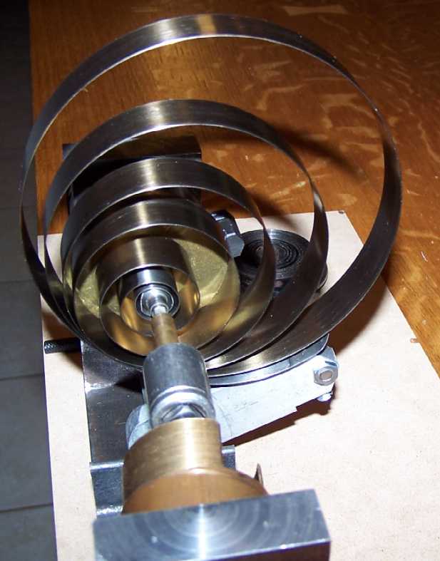

Joseph T. CollinsWinder in action. Ready to remove a spring from the barrel.
April 24, 2005, 11:16
Joseph T. CollinsSpring in capture sleeve. Home made sleeve by the way.
April 24, 2005, 11:18
Joseph T. CollinsSpring ready for cleaning or rewinding.

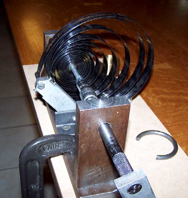

Joseph T. CollinsLoop end spring ready to wind.
April 24, 2005, 11:29
Joseph T. CollinsLoop end spring in 'C' clamp.
Note, I made up winding arbors for loop end springs as they are harder to handle with the great wheel attached. Hole end springs are handled with their own winding arbors.
I made the letdown keys from a couple 5 way keys. Removed each key from the group and attached a suitable hex nut.

Kevin PestorThanks Joe for the pictures , makes it much easier to understand.I think you have a great winder and maybe should patent your idea.This looks easier to use than the Ollie winder.

Tom SeymourJoe,
that looks very well done! Thanks for the extra pictures. It seems like it would be an easy system to use, and obviously, quite versatile.
The use of the three jaw chuck to hold the barrel is a very good idea.
You just have to get it in production now!

Doug OsborneHi,
I don't see a ratchet gear and click to hold the handle and spring when it is wound tight. Do you have to hold the handle and try to put the sleeve in while holding th pressure? Also you need various sizes of sleeves for various spring barrel sizes. Did you make several of these, if so, what did you make them from.
April 29, 2005, 16:29
Joseph T. CollinsHi Doug,
Thanks for the reply. There is no rachet assembly as it is not needed. With most winders one hand holds the barrel while the other hand turns the crank. The rachet is needed to hold the spring so the cranking hand can install or remove the sleeve. With mine the three jaw chuck holds the barrel leaving one hand free to install or remove the sleeve depending on which direction you're going, removing or reinserting the spring. I can start with a capped barrel and have the bare spring in my hand, ready for cleaning, in under 3 minutes without resorting to rachets.
I make my sleeves from whatever is available near the needed size. So far I have made them from brass pipe, (2 sizes) stainless steel pipe, (3 sizes) stainless tubing and aluminum tubing. It is very handy having a metal lathe and a well stocked scrap box.
Hope this answers questions,
Joe
