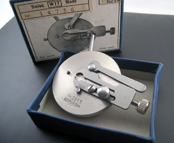

Bernhard SchmidtWhat is this?
Have tried to figure it out but, what is this?
Best regards!
Bernhard

Scott CerulloIt looks like it could be for setting pallet stones or for fixing a bent guard pin on the pallet for a double roller. ???

Frank JuchniewiczCould it be for closing the fork on the pallet.

Shawn JohnstonHi
It is for cutting guard pins.
Cheers Shawn

Bernhard SchmidtI sometimes have hard to understand the english terminology. What is exactly a guard pin. Do you have a picture maybe?
/Bernhard
February 14, 2005, 12:49
Kevin PestorHi Bernhard.If you go to John Duvall,s helping hand tutorials.Page 12 of components of a pocket watch it should help you understand more.
February 14, 2005, 14:06
Bernhard SchmidtThanks everybody for your help and participation. The helping hand tutorials,..what a great source.
/Bernhard
February 14, 2005, 14:11
Bernhard SchmidtActually,..when I look at the outer box I recognize the lever with the guard pin being cut.
