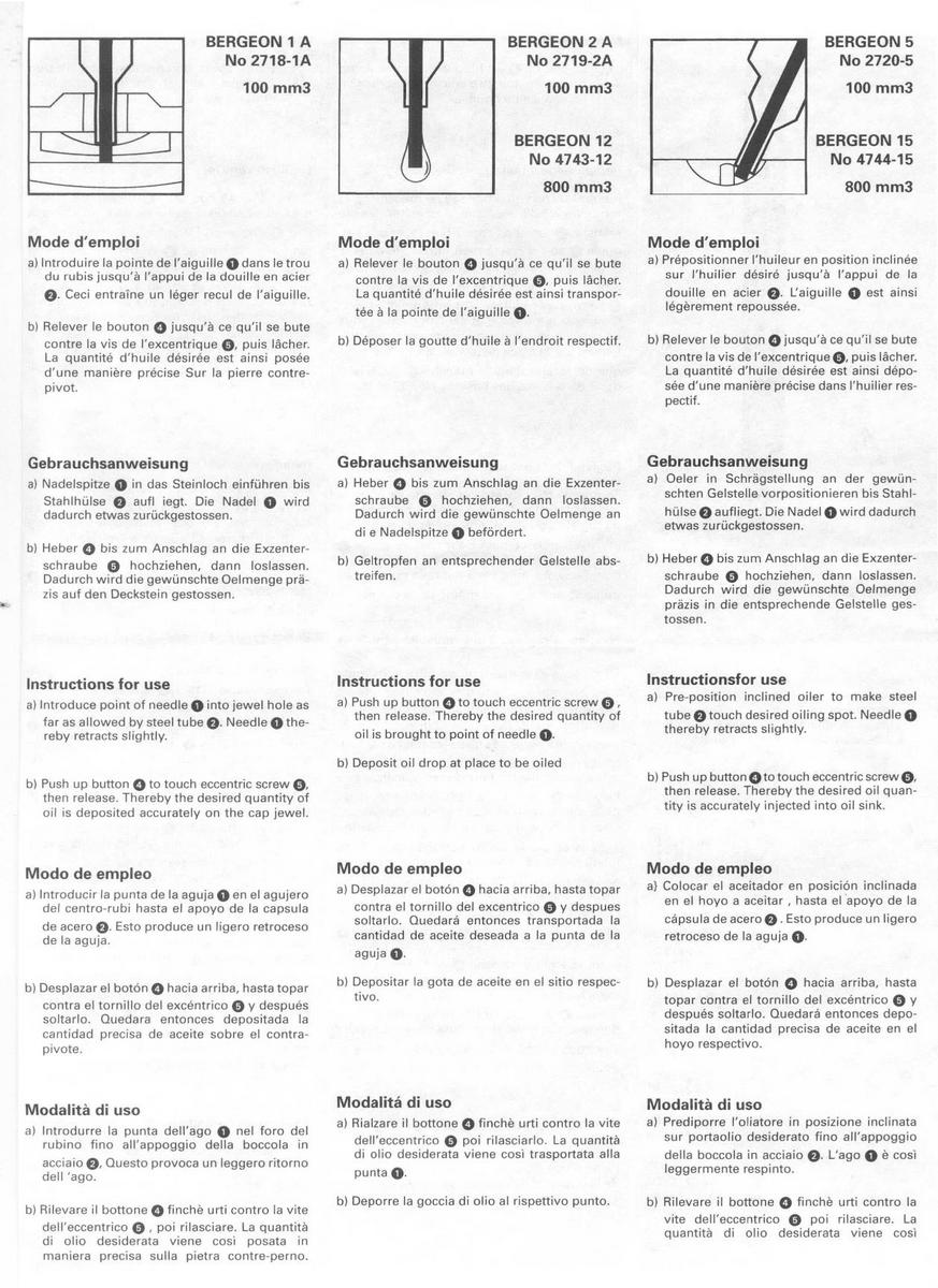

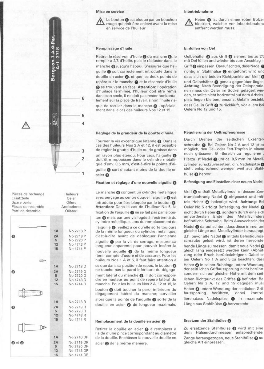

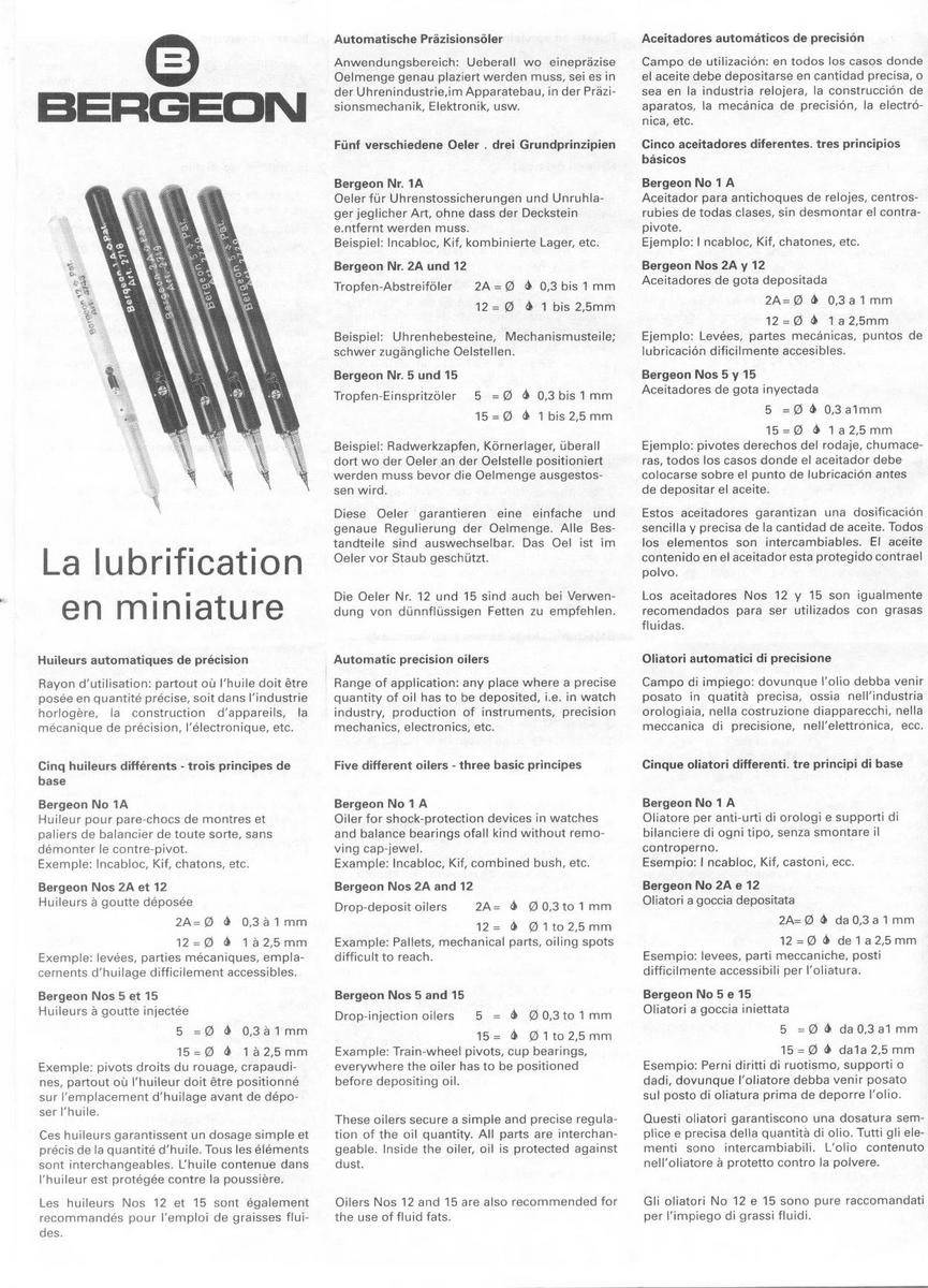

Peter ClareFollowing are some images of the file kindly forwarded by Bob...
