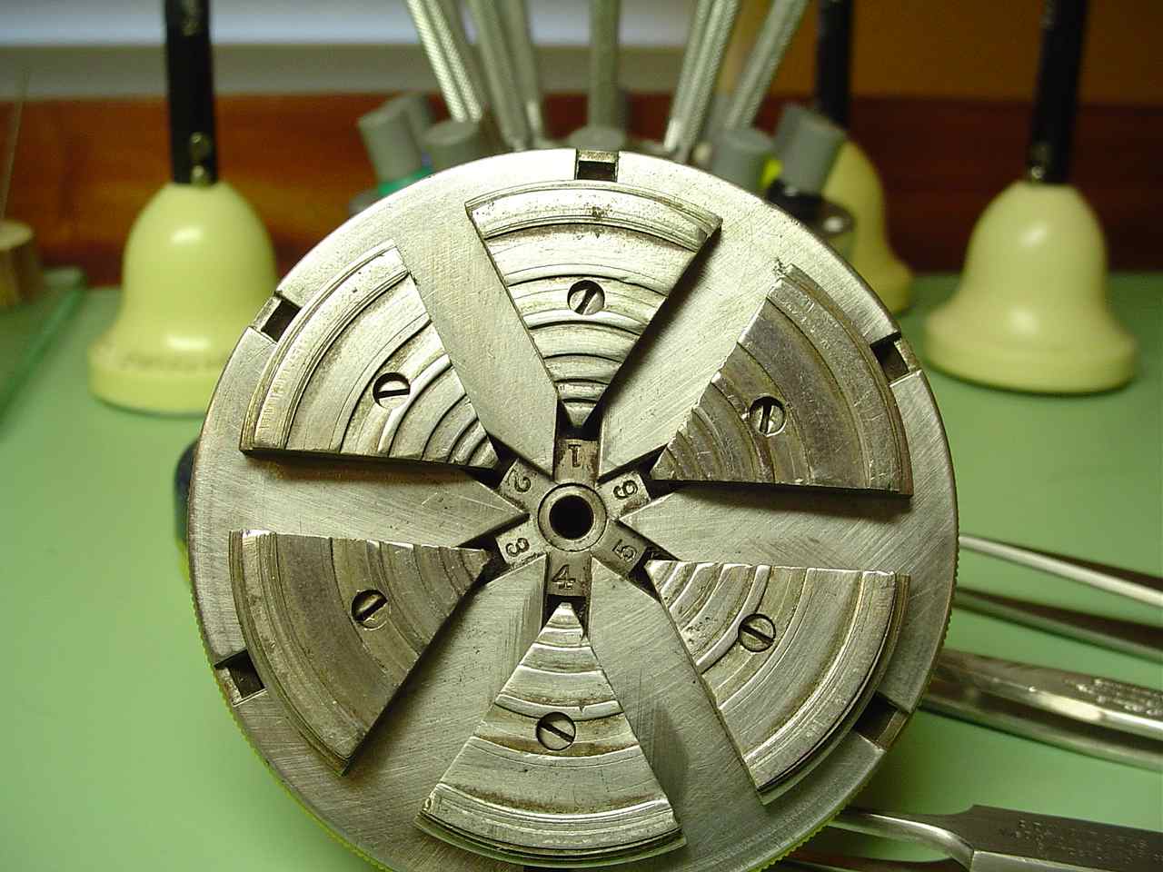

This may help. note anti clockwise direction of numbers. 1 starts left of key.

Hello Chris, Mine does not have numbers in the centre like yours does so I assume someone has removed them. Now that I know which way to go I will find the best option, there are only 6 to choose from, and re number the base accordingly.

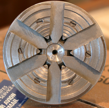

Had a chance to do some work on this project. Tried to put the jaws back on in the same direstion as Chris's chuck but it wouldn't work. I ended up with the 2 halfs of the key on the outer sides instead of together. So on my chuck the jaws must go clockwise. That left me with 6 options so I tried each with a bezel ring and chose the position that was closest to tru using a dial indicator. I put some numbers back on the body to set the positions and then cleaned up the inner steps to get the nice square edges back. Left the outer angled steps alone as they looked OK. It will never be new but now it is usable.
