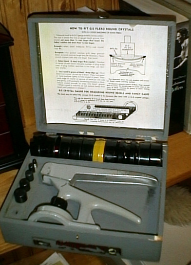

Mike MillerScott,
What type of watches are you most interested in working on? Crystal pressed are mainly for plastic crystals (Although some can be used as case presses for snap cases). Glass crystals on pocket watches don't need a press to set them. I have a G-S "Flexoround" press that I use that works well. It has several sizes of base blocks and plugs for various size crystals. I picked it up at a local mart for a few bucks.
