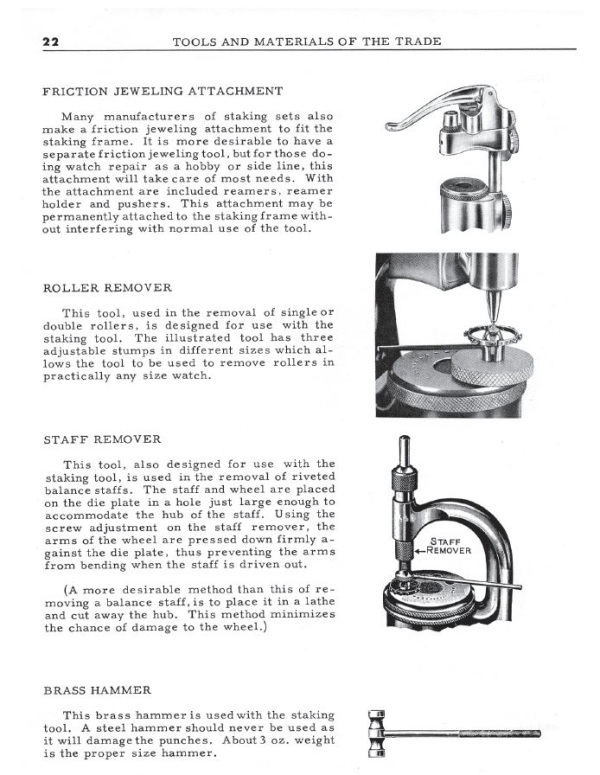

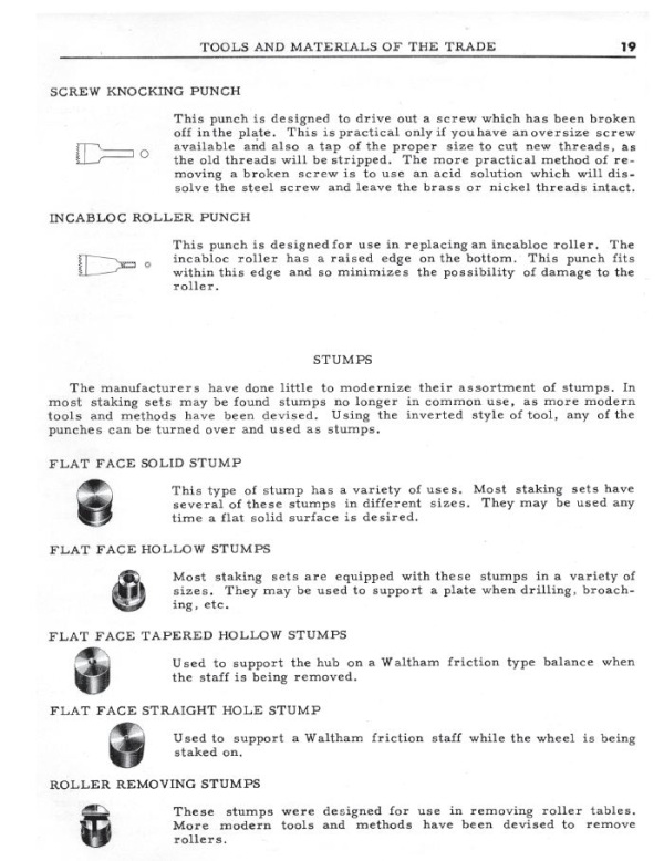

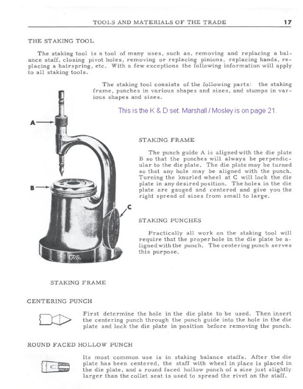

If you have, as I do, a Marshall staking set with the jewel pressing attachment on a Moseley press, I have found 5 pages of interesting material. How too's, What for's and descriptions. It has been very helpful to me and I discovered a new do-hickey in it too. A full set of reamers with handle. What the punches are for and how to use them was a highlight for me. Also I knew the cross hole punches were in the set but I didn't know they are specifically assigned to Waltham staffs.

Patrick Wallin

Patrick Wallin

Patrick Wallin
