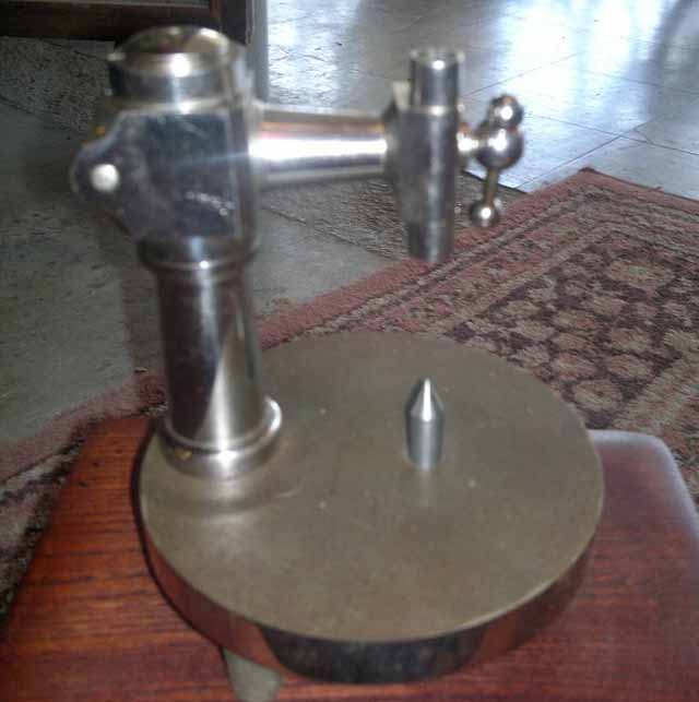

I have seen this item listed at my local Auction house as a "Watch Makers Too".
I can't quite work out what it is, I initially thought is might have been a hairspring vibrator, but close up, it has a pulley and looks more like a drill press?

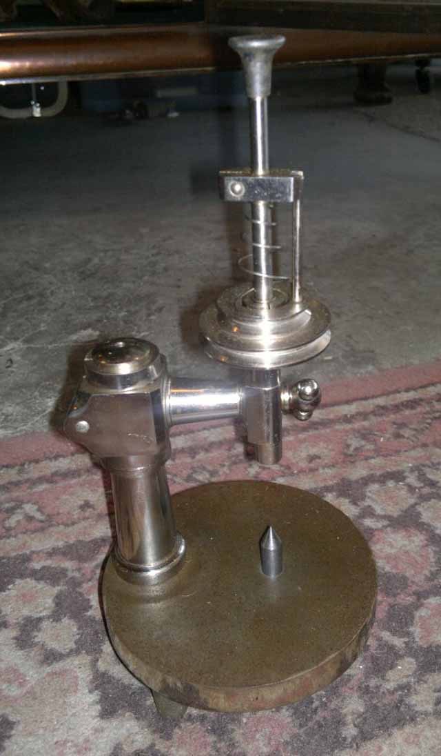

November 15, 2013, 00:11
Geoff Osborne
Another photo

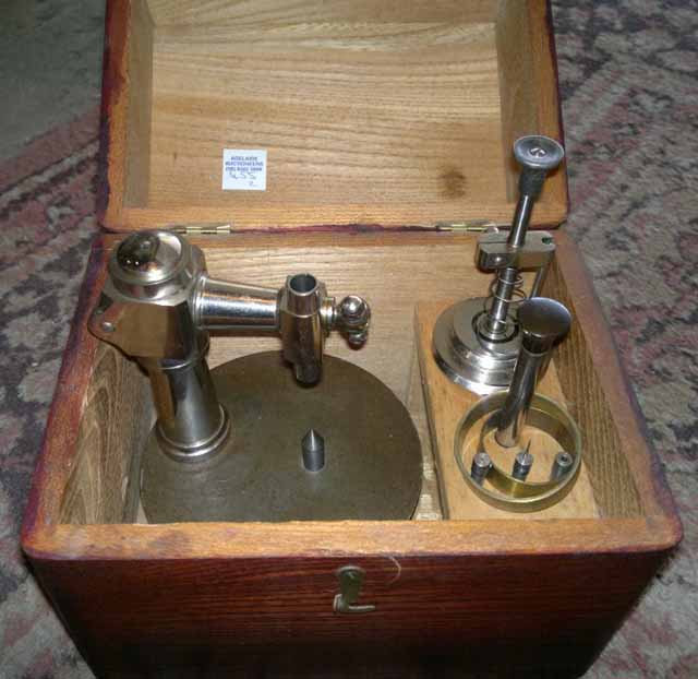

Geoff Osborne
Last one

It appears to be an Uprighting tool, for aligning holes between two plates or plate and bridge.
