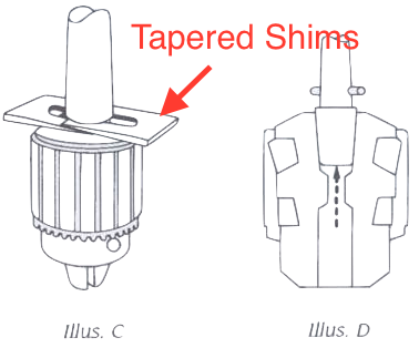

The initial install of the chuck just involves sliding it up  on to a tapered shaft then giving it a rap or to with a rubber or wooden mallet for a fraction fit.
Removal requires a specialty tool, two tapered U shaped wedges that you slide together till snug then tap with two hammers till the friction it overcome and the chuck is loose.

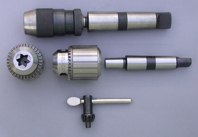

Bob MurrayDale-
The chuck should be mounted on a "WW" arbor.  Loosen the drawbar, and it should come right off, still attached to the arbor.  If the chuck is a Jacobs, there will be a number on it; 0, 1, 2,etc., and you can get a replacement key from a well-stocked hardware store or machinist's supply.  Don''t separate the chuck from its arbor unless you are going to replace it with another chuck.

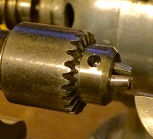

Mike BendaOn some hand drills, when you open the jaws there is a screw. worth a look.
April 07, 2016, 19:14
Mike BendaPicture is worth 1K word
The ol Morse taper.
The machinists like Lorne may chime in.
