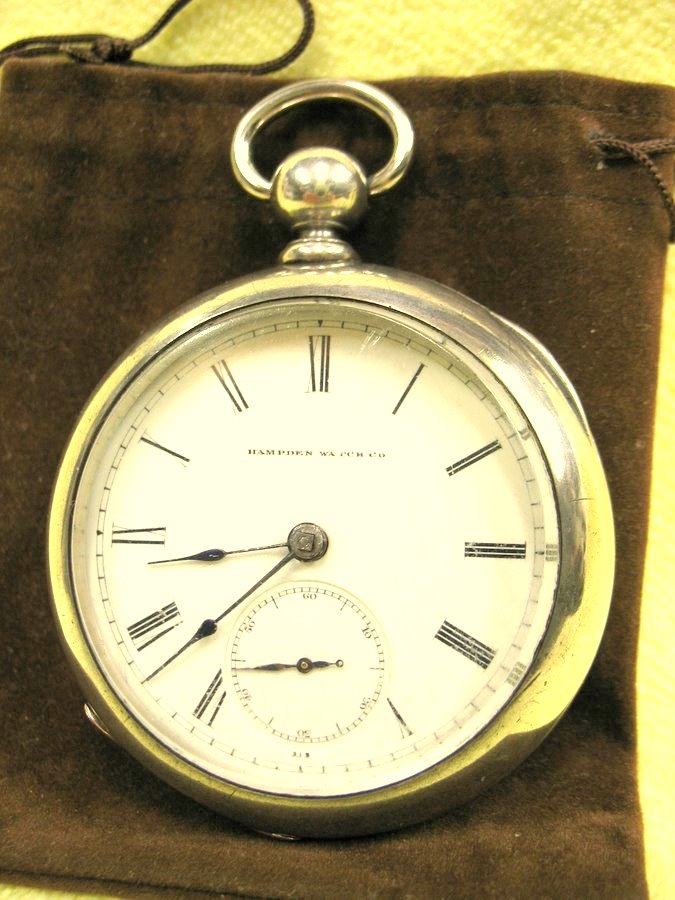

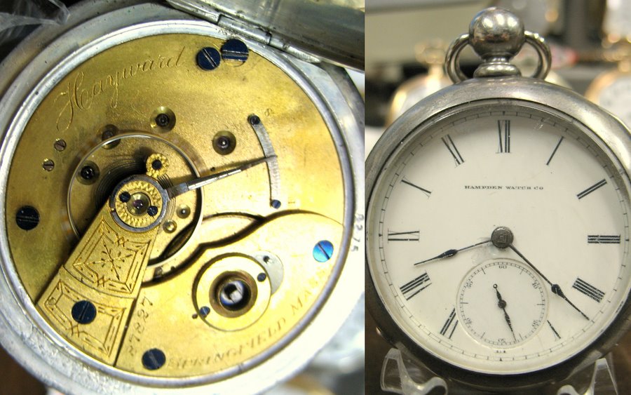

Another post discussed our dearth of Hampden discussions and I promised top show this Hampden made in 1878 during the "reign" of James Abbe when I was done with it after cleaning. Before . . .
April 28, 2009, 00:49
David AbbeAfter cleanup, the movement looked "factory new" . . .

David AbbeAll in All a really nice 130 year "new" Hampden "Hayward" model

Cecil McGeeHey David,
Very nice job.
I'm curious,Is this your watch? I have one just like it and,while I do my own repair work,I really don't know how to get that "new" look to the plates.
April 28, 2009, 13:49
David AbbeCecil, Yes it is part of my Hampden Collection.
As for cleaning the plates, with the exception of screwed in Hole Jewels,
EVERYTHING comes off the plates. Then I do an Alcohol*/Toothbrush plate wash to remove the organic stuff and a 15-18 minute spin clean with L&R "extra fine" Watch Cleaning solution, 5 minutes in L&R #3 rinse, dry and a complete plate wipe-down with clean Rodico. By that time anything that is "gonna come off came off"
