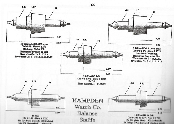

The staff you need depends on whether you have a small or large hairspring collet and SR vs DR. A #1720 fits the (L.C.) large collet.
RR
Page 166 Hampden Watch Co. by Hernick and Arnold

Sorry I forgot to get back to you but Richards chart pretty much explains everything..If it ends up you need a #1720 staff let me know and I will mail you one..

what is S.R. or D.R. ?
July 02, 2015, 17:51
Steven Ford
S.R. = Single roller
D.R. = Double roller

i just measured my hairspring collet and it comes out at .72 and single roller.
so i expect the 1721 that Leon sent me will be right.
and i guess the .04mm difference in measurement means the hairspring will be a nice snug fit.
