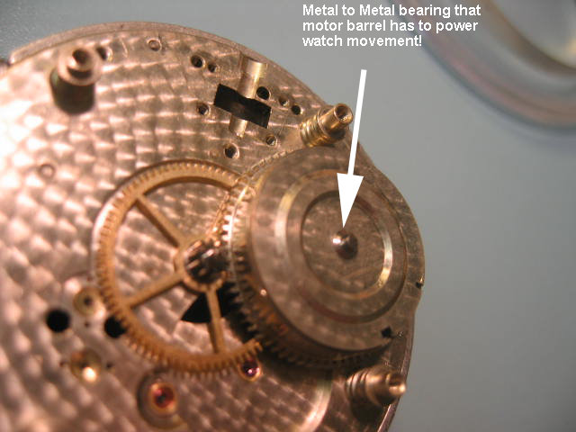

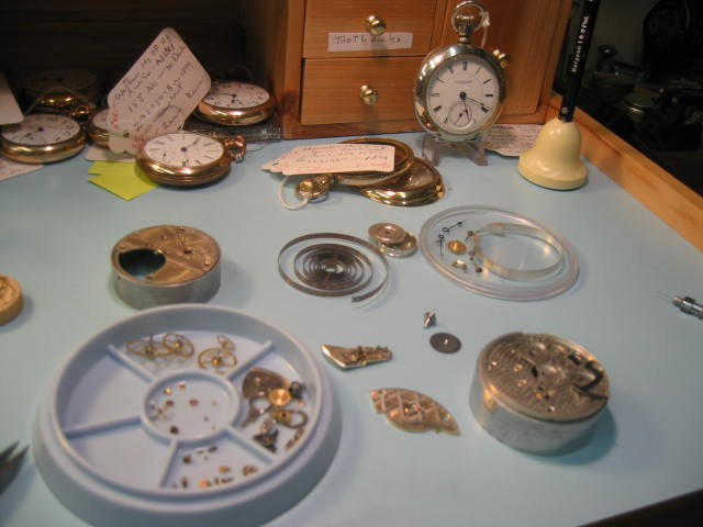

"Try it you (won't) like it!" This is what it looks like to reassemble the motor. In clockwise order from upper left;
1. Main plate before install
2. Install Winding Wheel with 2 torque lugs to connect to Barrel.
3. Drop in Barrel
4. Screw down Bottom Jewel Plate
Now you are ready to install the mainspring!

David AbbeIf you figure this out, the design forces the bottom jewel mounting plate to also do double duty as a terribly designed bearing "slip" plate for the winding wheel and main barrel when the watch is being wound!
The final two pictures show;
1. The installed main spring
 which I had to revise 3 times to prevent slippage! (Tha past watchmaker added a torque stud as the "T" spring just will not work!
2. The motor cover and main driver wheel that rides on the bottom mounted jewel, and pivots on the exposed jewel of the back plate of the movement.

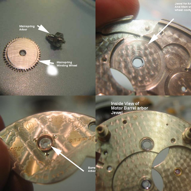

David AbbeThe below collage show in upper left corner the mainspring arbor and the winding wheel, then views of the main plate arbor jewel from the top side and the inside showing where the winding wheel is located. The fourth picture is the arbor jewel on the barrel bridge. The "collage program" clipped some of the words, but the story remains clear.

David AbbeSo as you can see, the arbor is "fully jeweled" to reduce operator stress whilst winding the watch. Than while the watch is running, the "Jeweled" arbor is not rotating at all in the jewels as it is locked by the click holding the winding wheel. SO . . . meanwhile, the motor barrel is still rotating against two metal to metal bearings between it and the arbor while powering the watch. A severe shock can and will damage the jewels that are holding up this whole stressed and heavy mess of parts and spring. That will tilt the arbor and lock the motor possibly damaging the main wheel too. I find these jewels as "pretty" . . .
