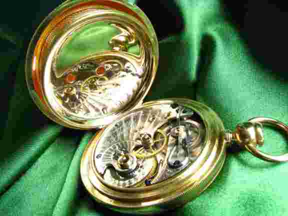

Here is one I thought I would post up for the fun of it, this old E Howard came to me I a very poor condition, filthy dirty all gummed up being the least of the problems. It, had been in a local watchmakers shop for three years!, the customer after many visits and numerous excuses retrieved the watch. Now in far worse shape then it went in and still awaiting a new staff. These old Howards have many variants on the staffs so I decided the quickest way was just to make one, (See pictures below of me roughing out the shape) Not something to be undertaken lightly due to cost and time involved in doing so. Well I am happy to say the watch is now running great and will soon be back in his collection, great case to solid 18K 100G

Gene FurryNice work Chris!! You did the right thing as I've found there to be 'variations of the variations' when it comes to Howard. You could have waited weeks on the so called proper staff, only to find out that it wasn't even the proper variation the supplier thought it was to begin with.
