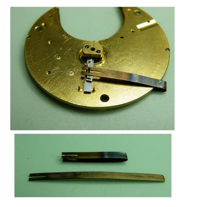

During assembly of full plate watches I am using a simple tool that I made in my company.
Some mainspring part with one end cut on a wire EDM machine. This help to hold the lever.
Is there a better solution?
Thank you.
Bulent Ogel
January 12, 2009, 15:50
Samie L. SmithBulent i have made these before but i coat my with shrink wrap like you use on elect. wires too keep from scratching the movement..something else that will work is a plastic coated paper clip..
January 12, 2009, 18:36
Bulent OgelGood idea. Thank you Samie.
Bulent

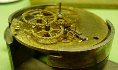

Lawrence FureThe correct way to assemble full plate watches is to assemble the train and lever on the top plate.
Doug Sinclair described the process in
this post.
January 12, 2009, 19:30
James H. Milleri hold mine with a small piece of rodico pushed in from the top.is there nothing that stuff cant do?
January 12, 2009, 20:41
Samie L. SmithLawrence i have tried both ways and i find the other way easier for me..
January 12, 2009, 22:03
Roger J. NolfeI do it the way Lawrence shows. I found it helps if I get eye level with the movement.
January 13, 2009, 00:33
David AbbeI posted this picture about 2 years (and about 150 18s full plate restorations) ago. The rodico works every time, and as you only have to set the bottom pivot of the pallet lever or fork, it is always easy "once you get the hang of it". This has helped me immensly on the 5th pinion models which would be a real bear to do the "conventional way".
