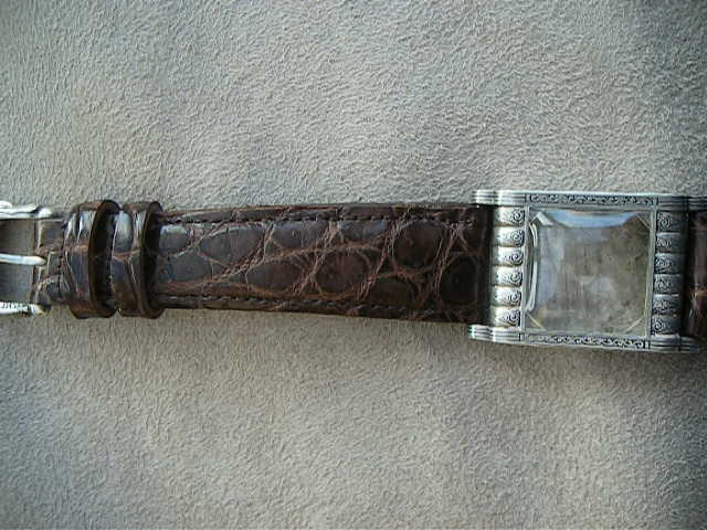

I have been trying for a while to match up a watch movement to fit this case
I got the NOS solid silver deco case, The case was absolutely filthy almost black took me the best part of a day to clean it , I sourced a genuine Deegan silver crocodile buckle from America, thats why I put the real crocodile strap/band on this watch just waiting for a movement and a dial hope you members can help
the dimensions for the movement, are 22mm round movement these are usually european 15 jewel movements
with a square dial of 20mm x 20mm or 21mm x 21mm at the most
this is another of my projects
some photo`s of the case
Deco top

I don't have a movement for it but, I wish I did!
When you find a movement please send a picture of the watch on your arm. It's a nifty case & band.

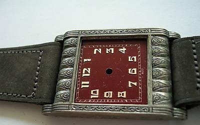

This is the state of it when I first got the Deco case cleaned it for the photo but it still took some elbow grease to get it somewhere near
the original strap I took off as it was very small and I could not fasten it on my wrist the case itself is unusual having spring pins in the lugs instead of wire lugs
original photo

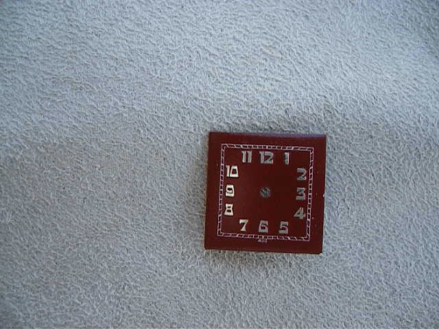

What is written at the very bottom of the dial under the 6.
Also does the case back have a brand name, I thought it might help pin point what movement was originally in it.

Put a ligne guage to the dial opening. It should probably show 10 1/2 lignes. If so a likely suspect would be AS 340, FF 1146, or maybe a Gruen watch specialties co. movement. I need to know thickness and a photo of backside of dial.

Tom you said you wanted to know what movement was in it I`m afraid their was no
movement in it as I got the case as NOS and the dial was with it the Dial is marked
under the 6`o`clock position "460" is this a Calibre reference
The square dial of 20mm x 20mm or 21mm x 21mm at the most
the problem is matching the dial feet to a movement I have got 2 movements that fit
but the dials on them are no good so I`m still at square one

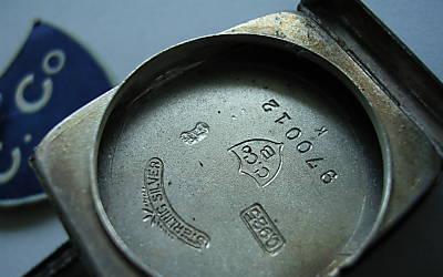

John Hodgson
and here`s the case back details
