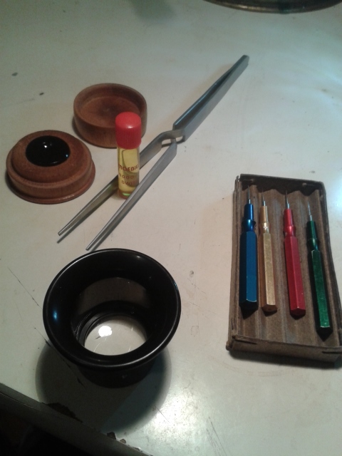

right now i am reassembling my 1884 elgin, just finished step 5 from Chris Abells' service checlist. so far so good. time to start oiling. and now for my embarrassing problem. how do you get the oil out of the bottle? i have tried inverting it, shaking it, using an oiler poked into it while upside down hoping capillary action would do the trick. yet my beautiful agate oil cup sits empty. do i stick a piece of pegwood into the vial and pull out a glob? i can't believe i am being beaten by this tiny expensive vial of oil.

Put your blue (2.5mm) screw driver into the vial of oil, pull it out and transfer the oil into your cup. If you do this twice, you will have a really good supply.
William

As William stated, and you'll only need a tiny amount of oil, just dip the very tip of your screwdriver, you'll get a feel as you get more practice.
