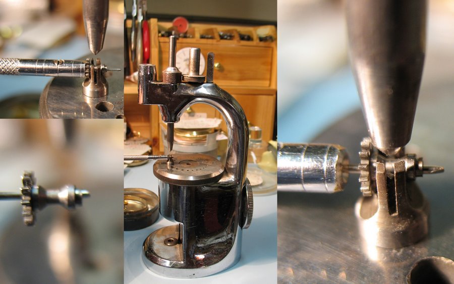

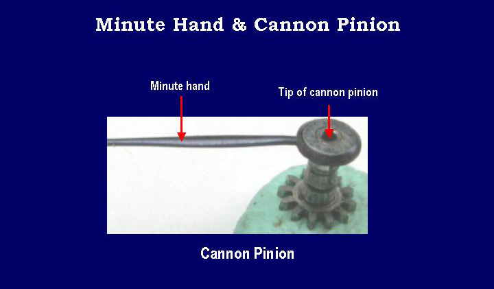

David AbbeUsing one's 19th Century imagination, it looks like a cannon barrel, hence, "CANNON" pinion. William, there are "stand-alone, and staking set cannon pinion tightening tools that work with about 60%-80% success excepting Hampden, Hamilton, and early Walthams all of which are a real bugger. The hair trick that Lin refers to will do the job often because the hair is actually squishy enough to "fill the gap" and keep some traction necessary to move the hour hand, intermediate and minute hand wheels.

The canon pinion repair can be a pesky repair. Dave's great pictures show the staking set ways to restore friction to the CP. There are also a number of tools dedicated to crimping, dimpling and tightening it. I have one other way I sometimes use on pocketwatches which is to add 2 or 3 burrs to the bottom side of the CP around the hole to create that additional friction. To do this I use a bench block and drop the CP upside down into the smallest hole it will fit in then use a straight edge punch to create the burrs around the hole. Tap lightly as it doesn't take much. Then test on the watch for fit.
