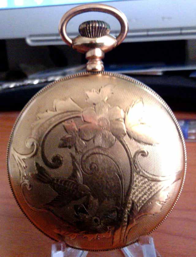

I have just rescued a rust damaged 18s waltham fortune case. It is quite attractive with a scew on back and bezal with flower and bird engraving. Unfortunatelty, the 15 jewel movement ha rusted out its cannon pinion and center wheel and will have to wait until i come across the right parts. Luckily, I have a nice(to me) 17j Waltham No3 movement that I have cleaned and fitted with a new mainspring. Its running sweet and drops right in.
Unfortunately, the claws on the stem/crown collet have rusted out so there is no stop between wind and set. I can remove the screw quite easily and the threads are fine.
Can the 'claws' be found separate or do I need a new collet? Also, are these case specific or can I just pull one out of any other scrap case.

Hello Paul the piece you are needing is called a Sleeve. It comes with the treaded parts and the claw all attached. There are different Diameter size and also the total length size's. A photo would be helpful.
