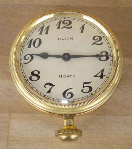

Serge BarlasHi Steve,
I'll upload some pic's. It is a large size 37 Elgin movement, early 27 million series, in a heavy duty cast case. It looks like the second pic you posted except it is cream faced. The back of the cast housing has the mounting point for the attaching bracket that would have been mounted to a dash.

June 11, 2014, 09:26
Serge BarlasPics of car clock...

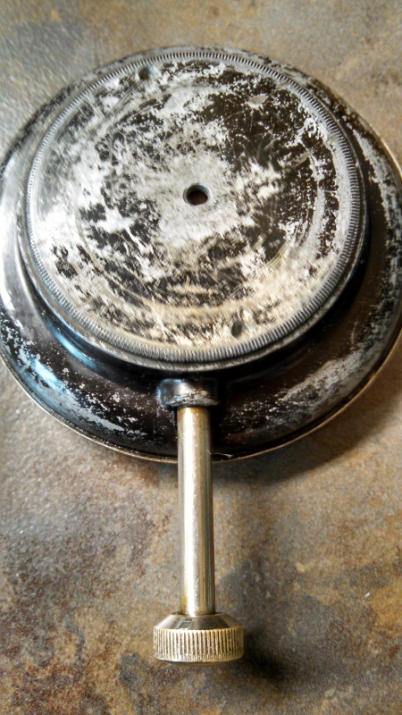

June 11, 2014, 09:32
Serge BarlasPic #2

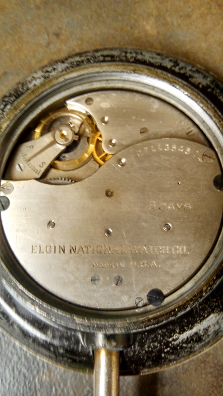

June 11, 2014, 09:33
Serge BarlasPic #3
June 11, 2014, 09:34
Serge BarlasFinal Pic of movement
