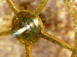

hi David, i found the problem and it seems to be me.
bottom pivot on the 4th wheel is broken.
March 19, 2015, 20:36
Todd Verriere
it wasn't broken when it came out of the cleaning machine because i inspected everything.
i must have broken it during reassembly.
glad i am only working on scrappers right now.
a lesson learned.
