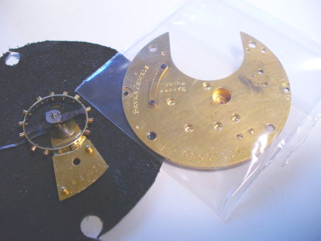

As U can C in the photo the dohickey was rubbing on the thingeymabobber. The Balance wheel tried so hard to run that it actually left a groove in the plate. The wheel wobbles in the hole but the staff looks good. I assume it's a jewel problem and have removed the bottom jewel. Top seems to be OK. I can't tell a good jewel from a can of shoe polish, but what else could it be? This is a Elgin, 18s, 7 j, # 13313958. In a silveroid case. Anybody got a cure? It's an old keepsake.

It coudl be a wrong length staff. wouldn't be the first time I've seen someone put the wrong staff in a watch. It would have a wobble, yet the pivots on the staff are good and the jewels are correct. The other thing it could be is the cock arm being bent. Hard to tell sometimes.

Could be the wrong staff like Jared mentioned..Also it might be the wrong lower jewel...The setting might be too thick not letting the cap jewel lift the balance up higher.

It looks like I can see the balance jewel in the picture so if there is only one jewel if would be the cap jewel that is missing...Is it an Elgin movement??Let me know and the serial number and I will check to see if I have one around here..If I do I will mail it to you...

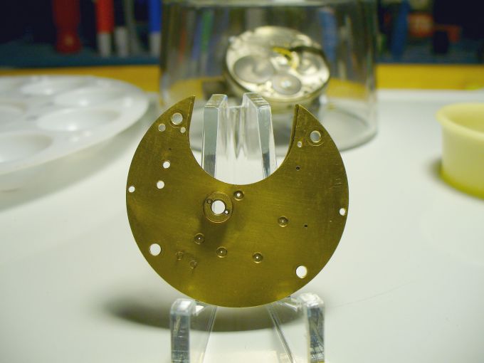

How about a picture of the back side of the plate.

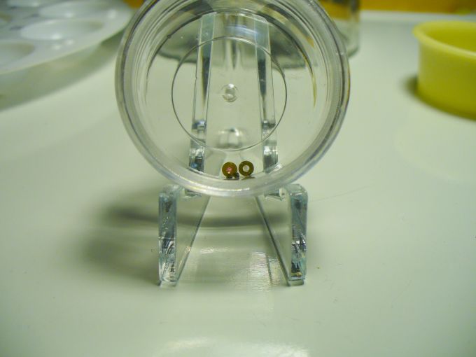

Eugene and everybody else, here are Pictures of the back of the plate and the jewel I removed. There is definitely something missing or broken.. I have double checked and the staff and can't really see inside the tight end of the hairspring but it looks as if there is a tit on the end of the staff.
November 16, 2011, 19:46
Patrick Wallin
Here is what I removed.

If the bottom of the staff pivot is good. and when you look thru jewels that are in the cup look good.then you will have to focus you attention on the top side of the balance staff. when you look at the jewels the one that has the hole in it should be a perfect hole not oblong or cracked. the flat jewel that is called a cap jewel should be smooth with no pit or hole where the end of the pivot has been wearing it. When you say tilt on the hairspring side then That is most likely the problem area.
