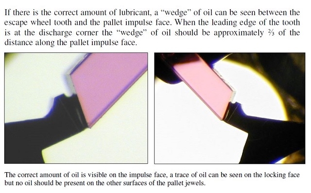

Below is part of page 10 from the British Horological Institute:
The Practical Lubrication of Clocks and Watches
The Practical Lubrication of Clocks and Watches Page 10
