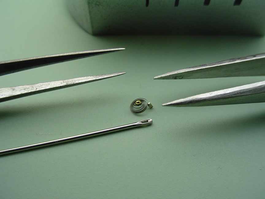

I was just talking to a watchmaker in the north and he runs a course, you may want to check out your local colleges see if anything going on there, visit you local watchmakers see how friendly he/she is and maybe able to point you to a group or club. I have a friend who does clocks only, does the full service, pick up, repair, delivery and set up, he say that works well as he has no questions when he leaves the clock is working correctly, collects his check at delivery. He does good work and charges a high dollar for this currently he has more work than he can do, clocks due to difficulty of shipping can very lucrative for the right person. I use to visit a clock shop in Rhode Island he opened something like 2 hrs twice a week (mid week!) to take in repairs and had them queuing to drop items off. He said that he did this limited opening so he could take in work and have the rest of the time to work in peace and allow him to make house calls. Something worth thinking about. For me at the moment I can work on the tiniest watches so sticking with WW & pocket watches, Fancy strightening a hairspring!
