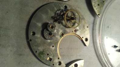

Kevin HoffmanHi Jeff , a few things that happen to me are the hairspring is not between the regulator pins ,dirty hairspring(coils sticking) wrong roller jewel , but most often is dirty jewels , pull it back apart and go through it again . This illinois was coated in hard green oil , it went through the washer twice and soaked , but still would not run right until I did it a third time and pegged the jewels again, let us know what happened .
