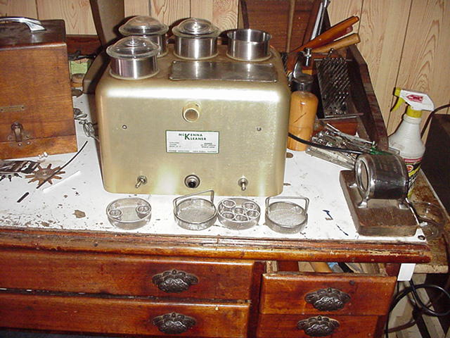

You are the ONLY other person I ever met who has a Mckenna cleaner. I have three ultrasonics hooked up inlcuding one new one. I swear the McKenna is the best cleaner. You don't have any literature on it do you?
Also, I havn't heard of Everclear since I was in the Air Force. I imagine that it would be one heck of a solvent.
I use mostly non ammoniated cleaner in the Mckennaa, but occasionally use the regular non foaming watch cleaner which has the strong ammonia smell. I have never had any sort of damage whatsoever to any watch part. Just 3 minutes in the cleaner, dunk it a couple times in the dunking cup and 3 minutes in the rinse. I swear it has twice the agitation of the modern ultrasonics.
One last thing. The ammoniated solution smokes in the McKenna. There is so much cavitation in it that it must vaporize the cleaning chemical. I started purchasing all my chemicals from Merrits. They seem to have the lowest prices.
November 03, 2008, 17:22
Charles W. England Jr.Scott, I dont have any literature, I got this one when I bought a deceased watchmakers complete set of shop tools, benches and all some years ago. Mine has two active positions, one for dip and a heater. It has a control to lower and raise the amplitude. All I've ever used in it is my home made ammoniated solution (distilled water,Ammonia, oleic acid and acitone. It also has a 1/2-1 in fog in top of the solution when I run it full blast. Pardon the mess, I'm still in the process of cleaning up. I guess us old guys tend to stay with what we started with, LOL, I still use my Little Giant rotating cleaner, self made cleaning solution, everclear bath coleman fuel rinse, and time them on my Watchmaster G7. I checked the tuning fork frequency on my G7 and LOL it was dead nuts on 240 hz even after all these years.
