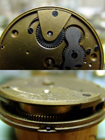

This is a parts movement I have, it is the little lever beneath the barrel. You know to have a stem in the winding arbor to slowly let down the power?
1883
January 18, 2009, 14:25
