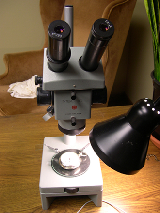

I can speak up here to extoll the virtues of my stereoscope (not a microscope). A stereoscope has two objectives retaining the virtue of seeing with depth of field instead of a 'flat' image that the microscope gives.
These tools are not cheap as a quick Google search will show. You will want one with the ability to adjust for the distance between your pupils. In my humble opinion, for watch work you won't need one that yields any more than 15 to 20 power.
In my stereoscope, you can see my eye pieces are 8X which means I need a fractional objective to magnify something smaller that 8X. My unit has a .5 objective so when the eye piece and the objective are multiplied,I get 4X.
I encourage you to surf the net a little bit and read about stereoscopes before you buy. I bought a Russian model. They are useful and FUN for a number of uses. Mine came with a light attachment that I didn't like, but I found a gooseneck lamp a good substitute.
Mine also came with the ability to remove one of the eyepieces and attach my 35mm camera. Thats cool, but I can hold my digital camera next to the eye piece and achieve the same thing.

Mike LaForestHere is another view of my unit...
