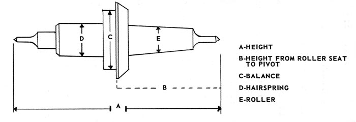

Melvin SiedmanPerhaps a picture like the one attached can be added to clarify the dimensions
Regards Mel
November 20, 2007, 17:48
Frank JuchniewiczMelvin
That looks like a good idea, I'll see if Lindell can incorporate it with the list; I don't think I could handle it.
