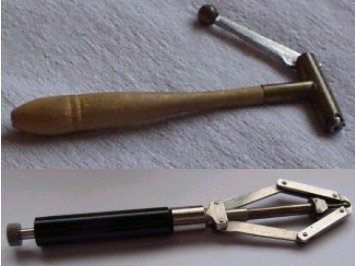

A old picture negative cut with a v works well - The best hand puller I have is an old K&D puller -top picture is a cannon puller, not well suited for removing hands.
Cannon Puller

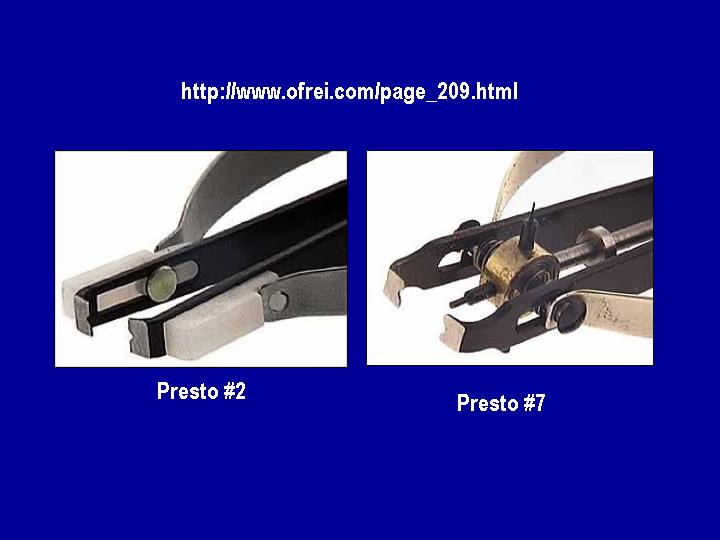

Is the cannon pinion remover you are referring to a Presto #2? If so, it also can be used for removing hands. The best hand remover would be the Presto #7. It does not make contact with the dial and puts no added pressure against the center wheel jewels when the minute hand is pulled.

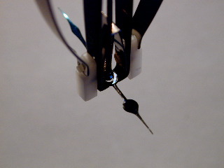

JohnD's pictures of two Presto designs prompted me to show the pictures you see below. The one I use is the Bergeon "Presto Number 1" which as you can see might actually be better suited to our use. I find it holds the hands securely and with this tool I have never had a mishap. To guard against loss I very carefully hold my left hand over the tool as a shield "just in case" and Charlie's idea of a "catch-bag" also sounds like good insurance. Searching the room for a hand with a magnet can be frustrating, time consuming and at times futile.
For what it's worth I've found we may be better off paying the extra money for the Bergeon branded tools. They really are better made, stronger and more reliable. Twice I did damage to a dial, the first time was without the proper tool using the screwdriver method John Fogerty mentioned above. The other was when a generic hand puller broke and slipped. I cannot too strongly recommend buying only top quality tools.
Bergeon Presto 1 has a spring loaded center plunger...

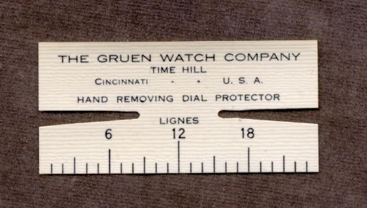

I also use a Presto #1, like Lindell's. The center plunger nicely keeps the hand from flying. I pull one hand at a time so as to not put excessive pressure on the dial. The fiber feet seem to protect most enamel dials from scratching, but for fancy metal dials I recommend a dial protector. As mentioned above it is easy to make a dial protector from a piece of thin film negative or mylar, or even watch paper. Here is a picture of an old celluloid give-away from the Gruen Watch Co.

Yes my puller is a Presto #2. Looks like you guys recommend getting the #1 for most uses, the #2 does not have the center plunger that holds the hand.
