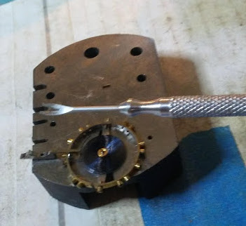

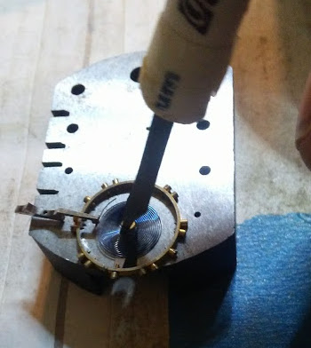

Hi James , do you have a picture of what your using ? Here are the tools I like , the first is a fork I think from KD they make a small and large , get the small , the other is a collet adjuster made from an old mainspring , if you place the balance in a v block the roller table hold it still , careful of the jewel , it should point towards you, rotate the collet while inserting and gently lifting

homemade collet adjuster, Daves watch parts had some other tools , including pliers- does anyone use the pliers ? http://www.daveswatchparts.com/HairspringTools.html

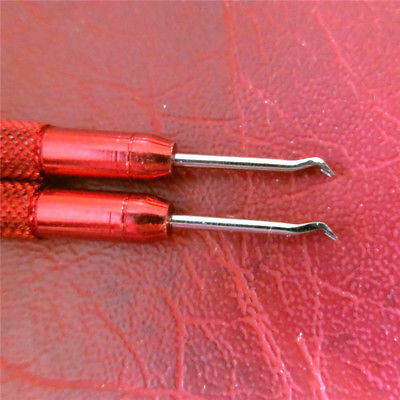

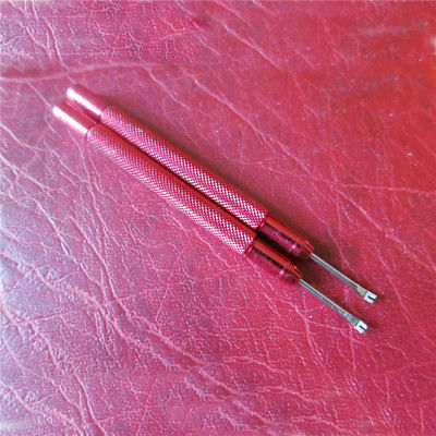

China red and blue handle on ebay.
I think I will try to thin them down on a stone.
They dont get under the collet very good.
May 12, 2019, 22:44
James Thorman
They just end up sliding up the brass and bend the spring without extra ordinary care. Just a bit blunt.

May 12, 2019, 23:59
Kevin Hoffman
actually I just slip it under the collet , I was shown to do both but the tool works really good , I have a set similar to what you have , and also damaged a few , I thought maybe they are too thick ?. I was really curious about the pliers also .
