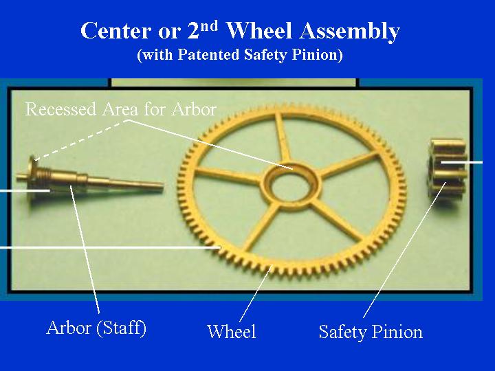

Just to add a little to the great responses posted so far on this discussion, is a slide that represents an Elgin 16s Center Wheel (aka 2nd Wheel).
Anytime you replace a broken mainspring, always remove the center wheel assembly and check for proper alignment of the arbor, wheel and pinion. Sometimes the pinion does not totally unscrew from the arbor and during winding it will retighten the pinion. If the arbor is not properly seated in the wheel recess, the wheel will wobble. The watch may run until the tilted part of the wheel comes in contact with the plates or other components.
After taking a movement down, I usually check all train wheel assemblies in my lathe to ensure they run true. This can also be done in the movement prior to installation of the pallet lever. Wind the watch slightly and check each wheel for wobbling or binding. This is easily accomplished on a 3/4 plate movement. For a full plate movement the wheels should be checked using your lathe or a pin vice prior to assembly.

Frank JuchniewiczThanks John.
For the very helpful tip,and illustration. I will certainly remember it when I go to tackle the mainspring job.
