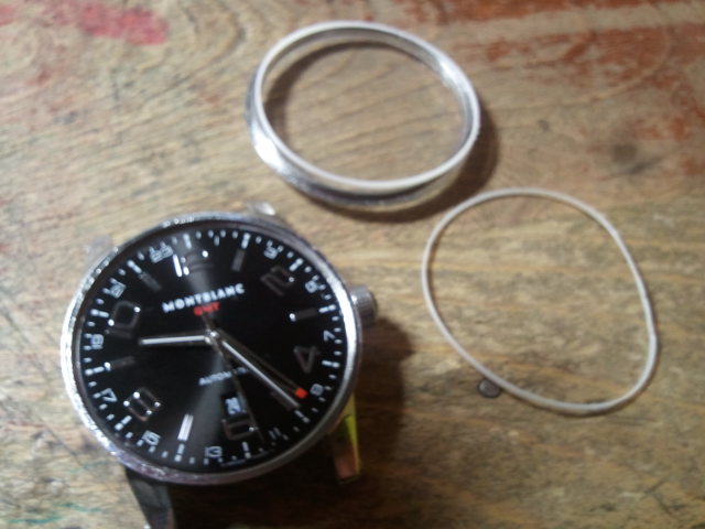

Hi everyone.
I am looking for some instruction in regards to reinstalling the front cover on my Montblanc Timewalker wristwatch. I purchased the flat gaskets based on the measurements from the old one. When I install the newly lubricated gasket and try pressing in the cover, it squeezes one side of the gasket and wont seat into place. Should I order a thinner gasket? I ordered the same measurement from the one I removed. PLEASE HELP.

Peter,
If your replacing everything as original and no damage or distortion occurred when you removed parts, you probably just need the press to apply enough even pressure to seat it.

I must of not put enough even pressure because one side keeps getting smashed. Is there something I should be doing before applying the pressure with my press. I put the gasket on the crystal side.

Peter,
without having it in hand hard to say, did you lube the gasket?, check the cover fits well without the gasket, look for dirt etc, trapped in bezel recess, check damaged edges, if its the same size as the one you removed should fit, could the old one be wrong that someone jammed in there, or stretched

It's very possible that the gasket is wrong. I ordered an assortment of gaskets that should be here by Friday. I will double check the rest of your suggestions as well. Thank you so much for your help.
