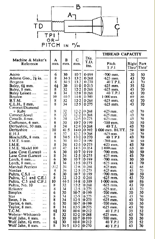

Does anyone know the thread count for a standard 8mm collet?
I know it's not 8 x 1.0mm.
May 18, 2012, 23:08
Richard Romero
Eric,
Maybe the chart below will helpful. With all the different manufactures it’s hard to say if there is a standard. A lot of the measurements on the chart seem to match the Webster-Whitcomb.
RR
May 19, 2012, 07:30
Eric Unselt
Thanks Rich. It would seem that 40 tpi is the same thread count as .625.
