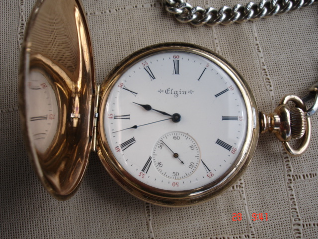

Having followed your advice on what movement to look for and having bought the replacement movement, I thought you might like to see the final result.
I replaced the original movement with a 15 jewel, double roller one. I also changed the dial, fitted new hands and cleaned up the case. I'm not sure if the hands are a matching pair. They don't look it to me. They came with the movement I used. The orginal hands on this watch, which I prefer esthetically, wouldn't fit on the canon pinion.
Thanks for pointing me in the right direction.
And the final result..

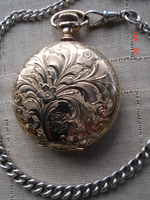

Irwin Foreman
And the case, which is also worth a look...

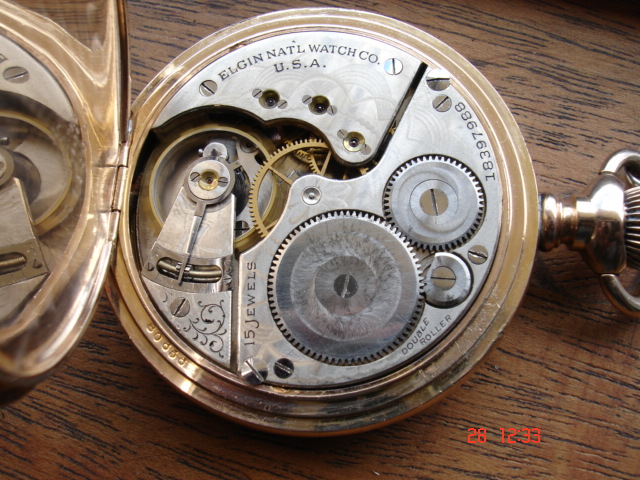

Irwin Foreman
And the new replacement movement doing its stuff...
