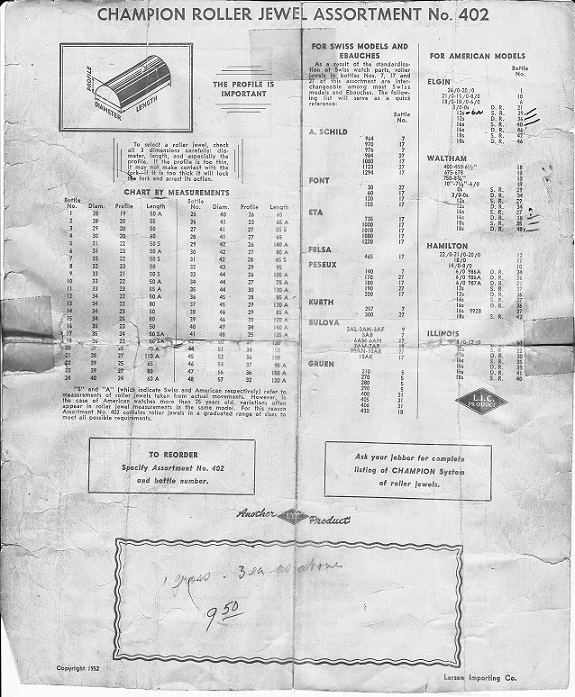

How does one go about converting a Elgin part number? Such as this roller jewel #2075 to actual measurements of width and length also material used such as rubies or whatever. I do not have one for this watch only a part number....

I do not know if this helps.

I greatly appreciate your response and posting of this watch artifact you have. It is too blurry to decipher for my Elgin watch because of the limited size you are permitted to up-load.

These old eyes (82+) reads my data sheet as 54 diameter, 37 profile, 95 long
