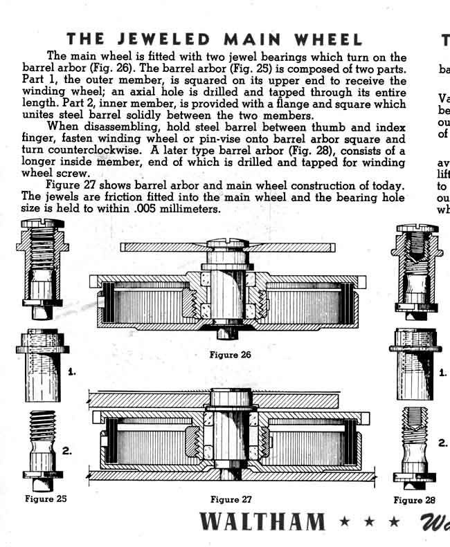

Assuming that the Waltham Ball has a jeweled barrel (that is NO cap jewels on either the pallet or escape wheel), here is the method I use to open the barrel for mainspring replacement or cleaning.
1. With the barrel removed from the movement, reattach the winding wheel onto the arbor square and secure it to the arbor with its screw.
2.Get a wide (1/8" or wider) rubber band, and wrap it around the smooth part of the barrel. It should not be wrapped over the main wheel teeth.
3. Holding the rubber band tight against the barrel with your left hand, rotate the winding wheel counterclockwise with your right hand.
The bottom pivot of the jewelled barrel screws into the arbor from the bottom. Normal winding tightenes this threaded pivot and it can take a bit of force to break free. However, once it does, it should unscrew rather easily. Remember, the arbor has two parts, in addition to the barrel and the main wheel. To reassemble the barrel, place the lower pivot into the barrel so that the pivot is seated in the square hole in the barrel. Then, holding the lower pivot firmly in the barrel square, screw the top part of the arbor onto the lower pivot. I find its easier to keep the winding wheel attached to the top arbor piece as you do this, then remove the wheel just prior to putting the barrel assembly back into the movement.

Jerry Treiman
The Waltham jeweled mainwheel (not a jeweled barrel) is nicely illustrated in the Waltham Watchmaker's Handbook.
