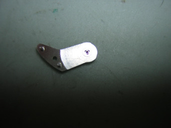

I have not seen this before. No screws, no antishock springs, but there appears to be something that is shaped like a kiflector. I am starting to doubt if these cap jewels are removeable for cleaning. If anyone has seen this before, could you please post something as to how, these cap jewels are removed.
Thanks.

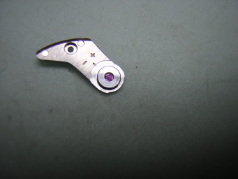

Hi Scott,
can you send a hi res close up pic 2

Scott,
Could that jewel setting possibly unscrew? Just a thought.
