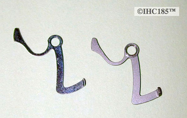

Lindell V. RiddleNEW WALTHAM SET LEVERS FOR MODEL 1908, 1899 AND BALL-WALTHAM
(Price to non-members is $87.10 including U.S.A. shipping.)
IHC185 Members Only price is $77.10 with U.S.A. shipping included.
We always ship via United States Postal Service for fastest, safest delivery.
Waltham Part 4760 on page 131 of "Illustrated Manual of American Watch Movements"
Here are some more IHC185 Members Only particulars...WALTHAM SET LEVERS FOR MODEL 1908, 1899 AND BALL-WALTHAMJune 24, 2009, 20:44
Steve MiddlesworthVery nice looking set levers.....nice job Chris and thanks Lindell for offering them up here.

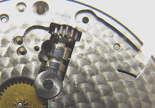

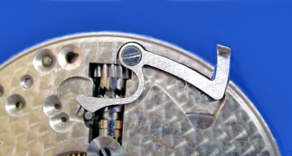

Bruce StewartLin/Chris (or anybody else), I recently bought a 16s Ball Watham at a country auction and upon disassembling the watch, found that the setting lever was totally missing. I should have noticed this during the preview, but it slipped by me. Anyway, I would be interested in buying a new repro lever, but it appears that I need more than just the lever. The attached photo pretty much shows the situation. I am definitely missing two screws, but from looking at your picture, Lin, it appears that there is a small shaft or stud that the lever pushes on (visible right below the lowest part of the lever in your picture). If these 3 other parts are difficult to find I may not bother fixing the watch. Can someone tell me the availability of these two screws and third component that the lever pushes on? I don't know if it is required, but the serial number of my watch is B134372. According to Shugart's Price Guide that should place it circa 1901-1903.

I had trouble putting one of those back together before & here is a link to some photos Lindell took to help me get mine back together, it might help you figure out which parts are missing. The part I had trouble getting back is the one I can see missing in yours. It might help to see if the other parts are still present under the bridge.
https://ihc185.infopop.cc/eve/f...541096103#7541096103Also if I remember correct some other Waltham models took the same parts, I have been trying to find that info for you but no luck so far. I will keep looking.

Tom BrownBruce, your welcome. I am sure there is another Waltham model with the same setting parts but I can not find which one. I remember after working on my Ball Waltham I then worked on another regular Waltham & found it was the same set up, I thought I still had it but haven't been able to find it.

If I remember right under the bridge & then under that disc is just the lever that moves the stem up & down from set to wind & then that wire spring you can see under it all. Just be sure to make not of how that spring is attached & which end to which screw, that was what messed me up to begin with. Forgot to photograph it 1st.
