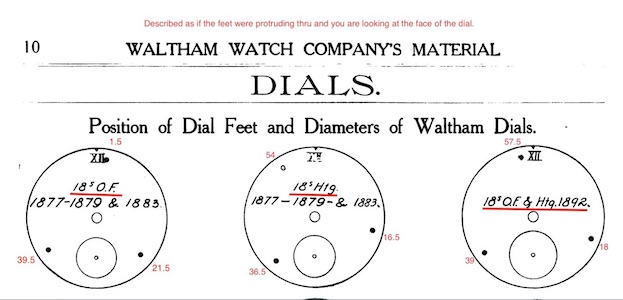

Needing to buy a dial for a m92 I have. My question is will m92 and m83 dials interchange, are the pins same location? Also will the hands interchange.
Thanks
IHC Member 703
March 15, 2018, 16:50
Lorne Wasylishen
There you go Steve.
1892 dials will fit both hunting and open face.
1883 open face and hunting are different.
The hands I doubt would interchange without broaching but I have not tried.

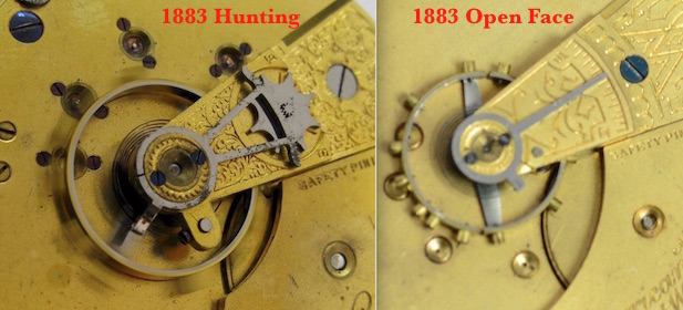

And in case you need it the jewel locations to differentiate between 1883's.
March 15, 2018, 17:16
Steve Morford
Wow, thanks Lorne. I will definitely make note of this chart. Thank you for your time!
