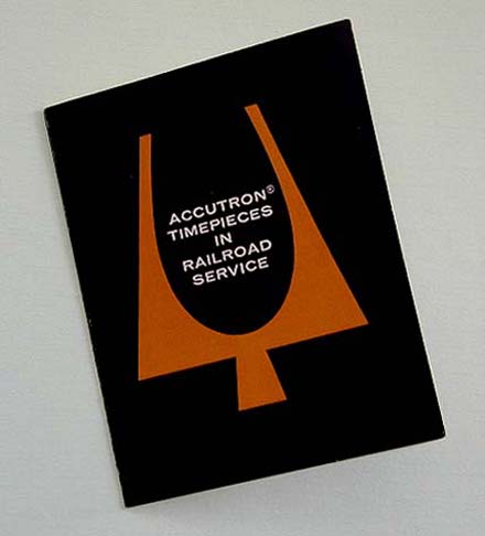

The Accutron was available in many configurations. Today the "Railroad Approved" models are special to many of us. In the next three images you'll see a booklet that was included with the 214 RR version. The information included may be helpful to any 214 owner and especially worthwhile in understanding certain points.
For those unfamiliar with Accutrons, the 214 sets by use of a setting handle on the back rather than a conventional crown.
Attractive cover of this informative booklet...
