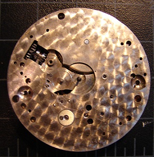

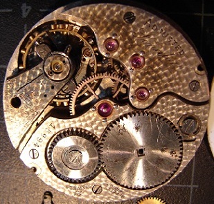

HELP ID 21J Screw Set Pocket watch Movement
21 jewel movement
Railroad Grade?
Sen@tor private label? Illinois?
I haven't found another with the same plate etc configuration

Roddy J. Brunton
pic 2
Roddy JB
May 16, 2020, 13:23
Roddy J. Brunton
pic 3

Douglas D. Weaver
It looks Swiss to me.
May 19, 2020, 15:23
Roddy J. Brunton
Thanks Douglas,
I wasn't expecting that.
Smile
Roddy JB
May 21, 2020, 10:46
Douglas D. Weaver
Clues to me are the cap jewel for the lower balance jewel and the shape of the balance cock - the position of the hairspring stud.
