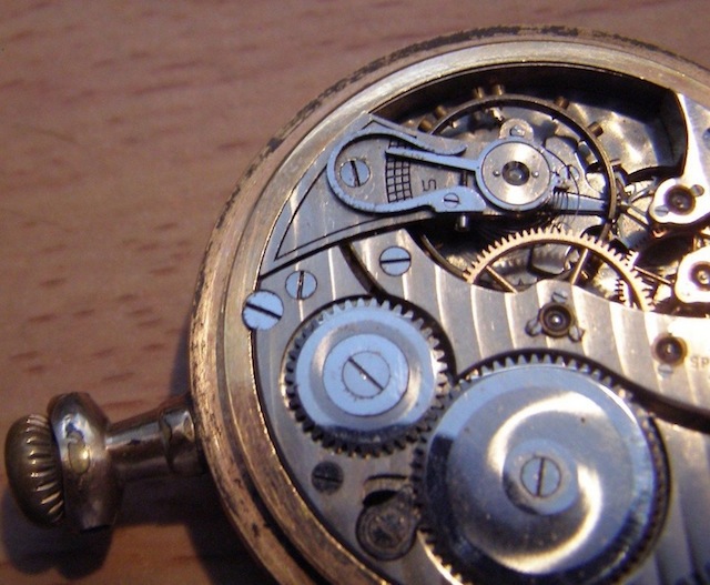

In the process of saving this poor soul from ebay
Here is the pic of the movement the seller had w/ the listing
Hairspring - sigh...
June 18, 2015, 21:40

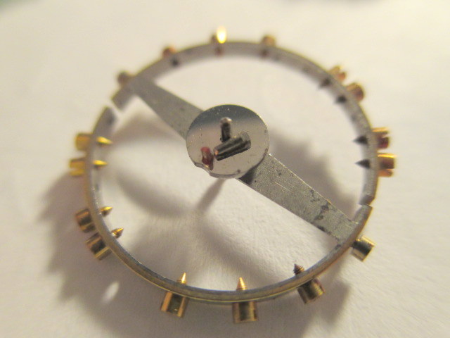

Jon HartOnce rcvd the watch noticed the balance arm was not completely flush with the movement plate (never a good sign). Lucky both pivots were good on the staff. However, the hairspring had been handled with club fingers and someone had forced a metal stake where a little glass roller jewel should live.

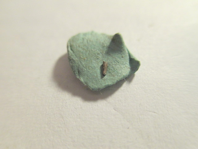

Here is the monster make shift roller jewel that was jammed into the roller table
June 18, 2015, 21:41
Jon HartYou can see the larger than normal size hole left in the roller table from the chunk of metal that was forced in
