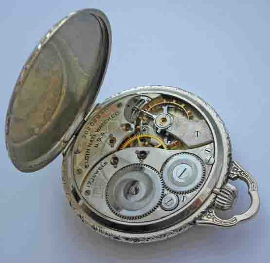

I have a 1927 Elgin 12s Grade 345 with a peacock dial. It is running intermittently and I believe it needs a good clean, could have a damaged staff or possibly one of the balance jewels is damaged.
Only thing is...how do I get it out of the case??? I am used to Elgin and Waltham 16s timers which have a crown stem screw. This has nothing. I remove the case screws, and the movement is loose in the case, but I cannot shift the crown. I'm sure I'm missing something obvious here - probably my lack of experience with this type of watch. Any help?

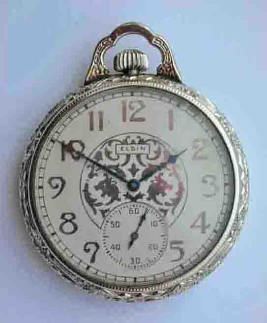

Simon Trevor Roberts
Some pics as requested.
May 07, 2008, 15:12
Here's another...

Thomas A. Overfield
You should be able to pull it down and out of the case. Pull the crown up to make this easier. There is no stem/crown retaining screw etc. for this movement. I'm not in any way a skilled repair person, but I've take movements like this out of dozens of cases. If it doesn't come out with a little fidgeting the something is wrong.
best,
Tom O.
May 07, 2008, 17:24
Simon
Tom is correct, if you pull the stem out to the set mode & then with the movement screws removed the watch should tip out the dial side starting at the 6 o'clock end first & then pulling the movement off the remainder of the stem.
As Tom said, most American made pocket watches do not have a stem retaining screw, the stem stays in the case while putting the movement in or out.

Marty Bell
I agree with Tom; if the stem is up like I said earlier and she's still stubborn, slowly turn the crown while gently jiggling the movement...that should do it...
Dial-side!! Ah-ha!! You see, my collection is mostly military stopwatches and timers and almost all my pieces come out back side (if you'll excuse the expression). I assume this is a snap fit bezel and not a screw? I don't want to force it off with a case opener when I should be twisting it!

May 08, 2008, 12:04
Simon,
I believe you will find the bezel is snap-fit in the same manner as the back. The big difference is, the bezel is not usually hinged. The little "ear" that is used to pry should be between 5 and 10 minutes but may not be installed in the correct position.
Like Marty advised, be very careful, work only in a well-lighted area over table or desk-top and use great caution because when it un-snaps it can get away from you. The reason they used a snap-fit design on these was in order to make the case design slimmer.
Many thanks for your help, guys. The movement is now out and waiting for me to dig in. The bezel was a snap fit (thanks Lindell) but was very difficult to detect as there were no witness marks where it had been removed before (or someone had been very careful/professional).
